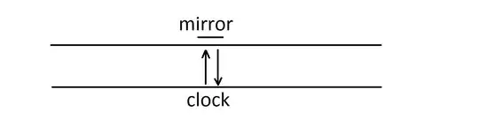

In the first part of the experiment the clock is standing in a train which is not moving so the clock and the mirror are still. As seen in the first picture (below).
light clock standing still

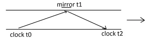

In the second part of the thought experiment the train is moving and the book suggests that the light travels a longer distance because the train is moving and therefore it kind of travels on a diagonal as presented in the second picture (below).
Now I disagree with this suggestion. I see no reason for the light to change trajectory or travel a longer distance. I argue that even when the train is moving the first picture still holds true.
There is also one more thing that it seems to me is wrong with that picture. There is no mirror against the clock at t0, no clock against the mirror at t1 and again no mirror against the clock at t2. This placement of the clock and mirror in time is crucial because it results in the longer diagonal path of the light but the clock and the mirror are moving at the same time! So the only illustration that makes sense is one where the clock is always against the mirror.
In the experiment it is said that light travels a longer trajectory with reference to an observer outside of the train standing still beside the railway.
I think that the train travels with reference to the still observer but the light travels with reference to the train. So I argue that regardless of whether the train is moving or not the light travels the same distance for the same time.

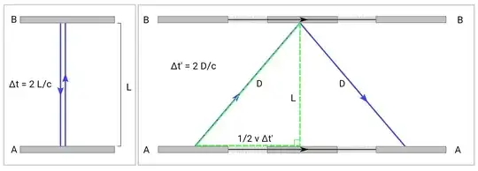

Now, let's get into what the question is about. Imagine two mirrors spaced at a distance $L$ apart (as pictured). Now imagine a light beam is projected from the bottom mirror at time $t_0$ in the direction of the top mirror; this beam is then reflected off the top mirror at time $t_1$ before returning to the bottom mirror at time $t_2$. The time between $t_0$ and $t_2$ can be expressed as
$$\Delta t=\frac{2L}{c}$$
Now imagine you see both mirrors start moving uniformly to the right. For someone moving with the mirrors, they will be stationary in their reference frame, so the situation will play out exactly as described above. However, for you, the light takes a longer path. After leaving the first mirror at time $t_0$, the light traverses the new distance $D$ and hits the top mirror at time $t_1^\prime$ before reflecting back into the bottom mirror at time $t_2^\prime$. The time between $t_0$ and $t_2^\prime$ can be expressed as
$$\Delta t^\prime=\frac{2D}{c}=\frac{2\sqrt{L^2+(\frac{1}{2}v\Delta t^\prime)^2}}{c}$$
The path of the light beam as seen from someone moving with the mirrors (left) and the path of the light beam as seen from someone stationary relative to the moving mirrors (right).

You decide to describe what is happening in this experiment using the frame of reference attached to Earth.
At some moment the first event happened: "very short flash of light was emitted". You know exactly where this event occured: at some point $A$ ("clock t0" on your picture).
Later on the second event happened: "the light reached the mirror and reflected".
And still later on the third event happened: "the reflected light was detected".
What's the coordinates of the third event? Where has it occured? At the moment of first event the detector was at point $A$. Definitely the third event happened after the first event, and as the detector is installed on a moving train, it was on some other point $C$ when the light was detected.
Where the second event happened? It must be somewhere along the upper line of your picture (because the mirror is moving along this line). It happened at some point $B$.
So, the description of the experiment in this frame of reference is: "At the moment $t0$ light was in point $A$, later on at the moment $t1$ it was at point $B$, and still later on at point $t2$ it was at point $C$. You can calculate distances between these points. Then suppose that speed of light is $c$ and calculate $t1-t0$ and so on...
