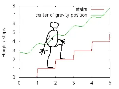

Image 1: Center of gravity movement
When ascending (or descending stairs), you bounce a little to not trip over the stairs. Your center of gravity moves along the $x$ axis of the image with two components: your roughly linear ascent/descent (depends on steepness of stairs, here 1 for simplicity) and a component that models the bounce in your step (also, alternating of legs). The image assumes $$h(x) = x + a \cdot \cos(2 \pi \cdot x) + c$$ Here, $c$ is the height of your CoG over the stairs (depends on body height and weight distribution, but is ultimately without consequence) and $A$ is the amplitude of the bounce in your step.

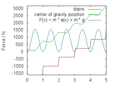

By derivation, we obtain velocity and acceleration in $y$ direction $$\begin{align} v(x) &= 1 - 2 \pi \cdot A \sin(2 \pi \cdot x)\\ a(x) &= -(2 \pi)^2 \cdot A \cos(2 \pi \cdot x) \end{align}$$ The total force your legs have to exert has two parts: counteracting gravity, and making you move according to $a(x)$, so $$F(x) = m \cdot g + m \cdot a(x)$$ The next image shows F(x) for $A = 0.25$, and $m = 80\ \mathrm{kg}$. I interpret the image as showing the following:
  1. In order to gain height, you forcefully push with your lower leg,
    a) counteracting gravity
    b) gaining momentum in $y$ direction.
This corresponds to the maxima in the force plotted roughly in the center of each step.
  1. Your momentum carries you to the next step. Gravity slows your ascent, such that on arriving on the next step your velocity in $y$ direction is roughly zero (not plotted $v(x)$). During this period of time right after completely straightening the pushing lower leg, your leg exerts less force (remaining force depending on the bounciness of your stride, $A$) and you land with your upper foot, getting ready for the next step. This corresponds to the minima in $F(x)$. Image 2: force for a = 0.25, m = 80 kg
The exact shape of $h(x)$ and hence $F(x)$ can be debated, but they should look qualitatively similar to what I outlined. My main points are:
  1. Walking down the stairs, you read the images right-to-left instead of left-to-right. Your $h(x)$ will be the same and hence $F(x)$ will be the same. So $$W_\text{desc} = \int F(x) \cdot \mathrm dx = W_\text{asc}$$The spent amounts of energy should be equal. In this case, the minima in $F(x)$ correspond to letting yourself fall to the next step (as many answers pointed out), but crucially, the maxima correspond to exerting a large force on landing with your lower leg in order to
    a) hold your weight up against gravity
    b) decelerate your fall to near zero vertical velocity.
    1. If you move with roughly constant $x$ velocity, $F(x)$ is proportional to $F(t)$. This is important for the argument that your muscles consume energy based on the time they are required to exert a force: $$W_\text{muscle} \approx \int F(t) \cdot \mathrm dt$$ Reading the image right-to-left, $F(t)$ is read right-to-left, but keeps its shape. Since the time required for each segment of the ascent is equal to the equivalent "falling" descent portion (time symmetry of classical mechanics), the integral $W_\text{muscle}$ remains constant as well. This result carries over to non-linear muscle energy consumption functions that depend on higher orders of $F(t)$ to model strength limits, muscle exhaustion over time and so on.
