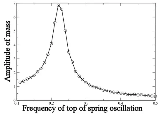

So the graph of the amplitude of the mass (driven) against the frequency
Note that this is for amplitude resonance.
For a plot of maximum speed of mass against frequency of the top of the spring the maximum velocity of the mass would tend to zero at both very low and very high frequencies relative to the resonant frequency.
When the speed of the mass is a maximum you have velocity resonance.
This is also true of the energy resonance and means that the energy of the mass at the end of the spring tends towards zero at low and high frequencies.
