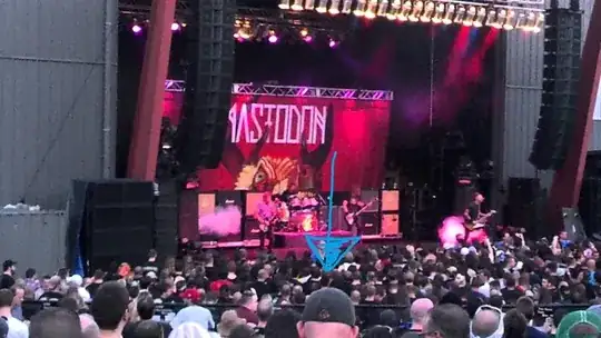

This was at the Columbus Pavilion and we were standing just right of the set of left speakers (blue arrow)
Columbus Pavilion Image Image credit Brock Bradley

If the lead guitar was playing a single note and that note was a pure sine wave and the sound from the guitar was reaching you from two different directions (e.g. the direct sound and an echo) then you could get a stable interference pattern.
In practice the sound will be echoing off everything in the hall so you won't get an interference pattern, and even if you did that pattern would shift every time the guitar played a different note. So no, the guitar can't sound quiet due to destructive interference.
However reflection of sound can cause focusing so the sound intensity can different in different areas, though concert halls are normally designed to minimise this effect. If there really was a difference in the sound intensities at you and your friend's positions maybe this was the cause.
