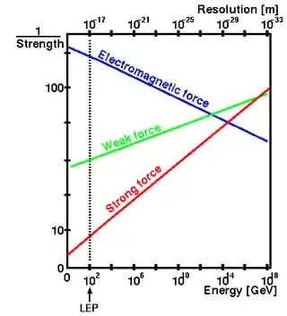

The elementary particles in the table do not acquire mass by exchanging anything in the form of feynman diagrams. The mass is acquired once, at the time of symmetry breaking of the electroweak interactions, where the three couplings approach each other :
symmbreak
when the couplings of the weak and electromagnetic change due to the Higgs field. One has to study mathematically this to be convinced, but the fact is , that the standard model as now known describes practically all particle physics data and is very predictive of new ones, as the LHC experience shows.
