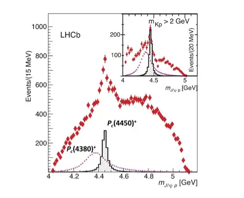

One is talking of new resonances within baryonic decay products, hard to see in the usual scattering experiments:
penta
The mass of J/ψ–proton (J/ψ p) combinations from Λb → J/ψpK-decays. The data are shown as red diamonds. The predicted contributions from the Pc(4380)+ and Pc(4450)+ states are indicated in the purple and black distributions, respectively. Inset: the mass of J/ψ p combinations for a restricted range of the K-p mass, where the contribution of the wider Pc(4380)+ state is more pronounced.
What do this data tell us:
The Λb has as three valence quarks udb and a mass of 5.620GeV . BUT it displays in its decay modes resonances attributed to penta quarks.
If one could have had a J/Ψ beam of mesons the way one can have a K- beam, and could scatter J/Ψ on protons these resonances would appear in the scattering experiments. As the J/Ψ has such a short lifetime and as a neutral is hard to manipulate in a beam, this is the only way these can be seen and classified.

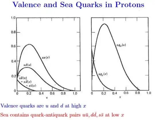

In the proton itself, there does not exist enough energy for the virtual quark-antiquark pairs of the sea to acquire a type of "valence" state.
The sea quarks and gluons in the proton graph in prof. Matt Strassler's site you quote, have different energy contents.
quarks etc
The contribution of sea quarks in scattering experiments is very small as seen by the antiquark distributions. If a valence pentaquark existed within the proton, it would have appeared in the deep inelastic experiments which probe the parton distributions.
Think of nuclear models where models with alpha particles internal to the nucleus are used. This cannot happen in the proton because of the large energy scales introduced by the strong interactions.
