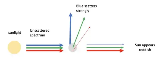

The answer is Rayleigh scattering.
Rayleigh scatter probability scales with the inverse 4th power of the wavelength - so shorter wavelengths have a much higher probability of scattering. This makes the sky blue, and the setting sun red.
As you add more (small) particles to the air, a relatively shorter path of light is sufficient to scatter the blue (shorter wavelength) components away - leaving you with a red sun.
You might be interested in this answer I wrote earlier - it gets into a lot more depth on the question of particles in the air, and how they affect the appearance of the sun.
A little diagram to help:
