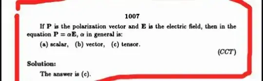

I don't understand the concept of tensors. Can anyone explain the relation between polarization vectors and tensors?

The components $P_i$ of your polarization vector $\vec P$ need not in general be proportional only to the corresponding component $E_i$ of your electric field $\vec E$. If $\alpha$ is a scalar then certainly $$ P_i=\alpha E_i $$ but you can imagine a situation where $$ P_i=\sum_{j}\alpha_{ij}E_j $$ i.e. the polarization in the direction $i$ is a (linear) functions of all three components of $\vec E$. In this case, $\alpha$ is properly a $3\times 3$ matrix $$ \alpha= \left(\begin{array}{ccc} \alpha_{11}&\alpha_{12}&\alpha_{13}\\ \alpha_{21}&\alpha_{22}&\alpha_{23}\\ \alpha_{31}&\alpha_{32}&\alpha_{33}\end{array}\right) $$ and so is thought of as a tensor.

Polarization is a vector quantity which is related to the Electric field (also a vector quantity) by some equation. There is a quantity alpha in front of the vector electric field which is a tensor. So to understand what the equation means you should know the difference between a vector and a tensor.
Vectors and Tensors are some quantities which transform in a particular way, which is different from each other. If you have dealt with the mathematics of vectors then you might know that a vector can be represented as a column matrix where each element represent the components of a vector.
On the other hand tensors are represented in the form of a N x N matrix, depending on the dimension of the problem.
In the above case the tensor alpha is a 3 x 3 matrix. So if you multiply a 3x3 matrix (alpha) to a 3x1 matrix (E), then the result is a 3x1 matrix (P).

When the dielectric is isotropic then the quantity α is scalar and x component of polarization vector depends only on x component of electric field and similar results for y and z components. If the dielectric is anisotropic then x component of polarization vector depends on all x,y and z components of electric field and similar is the case for y and z components. In this condition polarization vector is related to electric field vector by taking nine components of the quantity α in 3D space as in this condition α isn't a scalar, it's a tensor of rank 2. In fact, tensor analysis is the generalization of vector analysis. All physical quantities are tensors. Scalar is a tensor of zero rank, vector is a tensor of first rank, diadic is a tensor of 2nd rank etc. You must remember tensorial form of physical equations are invariant under coordinate transformation.
