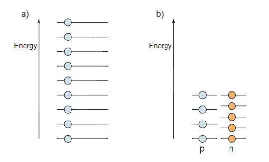

I'm guessing that the previous question referred to is What makes the number of neutrons the number of proton similar?, and in that question I used the following diagram to explain why the numbers of protons and neutrons were roughly equal:
Nuclear energy levels
So equal numbers of protons and neutrons gives the lowest overall energy. However this assumes that the energy levels for the protons and neutrons are the same, but they are not. Protons repel each other due to their charge but neutrons do not, so the energy levels for protons are more widely spaced than for neutrons. A better (though still just schematic) way to draw the diagram would be:
Nuclear energy levels 2
As before we imagine starting with all protons and converting protons to neutrons to lower the energy. But now because the neutron energy levels are more closely spaced than the proton energy levels we end up with more neutrons than protons.
The effect of the electrostatic repulsion increases with nucleus size because the average spacing increases as the cube root of the number of nucleons. That's why the disparity is larger for larger nuclei.
You specifically ask about the shell model, and this is basically the idea that the nucleons occupy energy levels much like the electrons in atoms. So my argument above is essentially using the shell model, though I have greatly simplified the details.

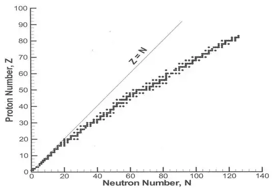

This experimental plot is relevant:
wtabblenucl
All stable nuclides
So you are asking if the nuclear shell model can fit these data.
The nuclear shell model developed because of the magic numbers observed in the stability curve:
remarkable patterns like the "magic numbers" in the stability of nuclei suggested the seemingly improbable shell structure
