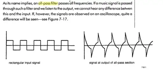

I don't know if you'll find this illuminating or not but I did find it so when I was asking more or less the same question to myself when I was an undergraduate electrical engineering student.
Consider the all-pass filter, an electronic circuit that passes all frequencies with equal amplitude but unequal phase. If a square wave (approximation), whether produced by a switch or not, is the input to an all-pass filter, the individual frequency components at the output have the same magnitude as at the input but have a different phase relationship.
Remarkably, this produces an astonishingly different output waveform.
Google books credit
The output waveform certainly doesn't look like a square wave but it has the same frequency components in the same proportion (just different phase relationships) as a square wave. Indeed, this output waveform could be the input to another all-pass filter that is the inverse of the first and its output would be (ideally) the original square wave input to the first filter.
Take some time to think about the implications of this.
