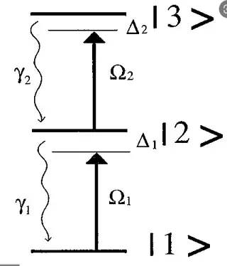

Consider the following diagram:
A photon can make the state transition from $|1\rangle \rightarrow |2\rangle$, if the photon is the right energy and the atom is in state $|1\rangle $. But they key is that the photon needs to match the energy level difference between 2 and 1. Likewise, the same thing can happen if the atom is in $|2\rangle$ initially and the photon has an energy level difference equal to the energy level difference of the excited states 2 and 3.
So, we can get what you described if we sent a photon with energy $\omega = \omega_3 - \omega_2$ when the state is $|2\rangle$, then it will transition to $|3\rangle$.
But what if we sent a photon with energy $\omega = \omega_2 - \omega_1$ when the state is $|2\rangle$? Now it can't get excited again to the excited state $|3\rangle$ because its too far away in frequency. This is the case that causes stimulated emission. When light is sent on-resonance (same energy) with a transition, it generally causes the atom to flip-flop between excited states. So light will cause the atom to transition from $|1\rangle \rightarrow |2\rangle \rightarrow |1\rangle \rightarrow |2\rangle \rightarrow ...$. When you consider just a single photon, then essentially only a single step of this process can happen. In $|1\rangle \rightarrow |2\rangle$ a photon is absorbed, in $|2\rangle \rightarrow |1\rangle$ an extra photon is created.
