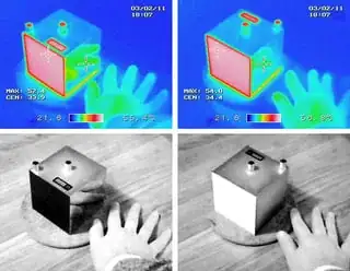

Another point to consider is that being black or white are object characteristics with respect to visible frequencies of light, while at room temperature most of the emission/absorption happens at lower frequencies (infrared). For example, the infrared pictures of the aluminum box below make it evident that the emissivities of its white and black surfaces are very similar (as explained in its manual).
Source: Wikipedia
Answer: Now, if the cups are "black" and "white" at infrared, than the black cup will cool faster, since it's emitting energy through radiation at a higher rate than the white one (and absorbing less then emitting, since the environment is cooler).
