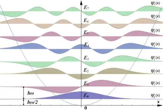

To understand them it's possible to simply look at the quantum harmonic oscillator (like weight on the spring, but quantized). As a matter of fact the free quantum field can be represented as infinitely many harmonic oscillators.
The quantum harmonic oscillator have discrete spectrum of the eigenstates - states with definite energy. Their wavefunction are spread over some region and don't change in time except gaining some unobservable phase. Thus their probability disribution remains the same spread over some region. In fact the average position you would measure is zero.
Eigenstates of the quantum harmonic oscillator
Nothing like a classical weight having some definite position oscillating back and forth. In the QFT they correspond exactly to the quantum particles like photon. It's not a wave in any classical sense, rather we can associate with some sort of the de Broigle wave with all restrictions in case of photon I've mentioned.

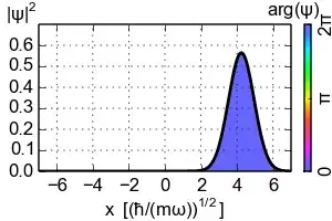

However you may consider certain superposition of those eigenstates and obtain something known as a coherent state that corresponds to the probability distribution concentrated near some specific position oscillating in time.
Coherent state probability distribution
That looks more like a classical weight on the spring, isn't it? Indeed you may find that it is coherent states that behave according to the classical dynamics in certain limit, not the eigenstates. In the field theory context the coherent states of the electromagnetic field behave like some sort of a "fuzzy" classical EM wave. The higher the intensity the more classical they appear but for low intensities it appears more like a random number of photons.

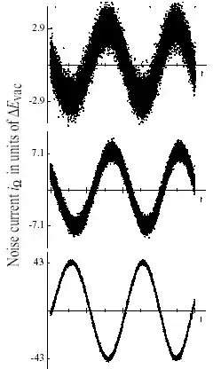

Electric field measured for the coherent state
What's about actual light? The radiowave or sufficiently strong beam of laser are good examples of light coming from the coherent states of EM field. However the light from a lightbulb is not coherent and to describe it with classical EM wave is actually not very appropriate.
