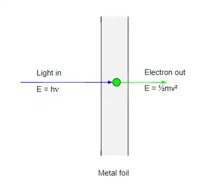

For simplicity let's consider the photoelectric effect in a thin metal foil:
The first step in the photoelectric effect is when a photon strikes an electron in the metal and transfers all its energy to it. The electron energy is now equal to the photon energy $h\nu$. If this energy is greater then the work function $\phi$ the electron can escape the metal and will emerge with a kinetic energy:
$$ \tfrac{1}{2}mv^2 = h\nu- \phi $$

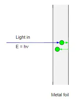

However the $h\nu \lt \phi$ the electron will in effect bounce off the metal-air interface back into the metal:
PE effect
and the electron will start rattling around inside the metal. The trouble is that the metal has some resistance to the motion of electrons and the electron will very quickly lose its energy and come to a halt. By very quickly I mean less than a nanosecond.
So if a second photon strikes the electron before the electron has slowed to a halt, and while the electron is travelling in the right direction then yes the second photon could add enough energy to eject the electron. So in that case we would have photoelectrons ejected by absorbing two photons.

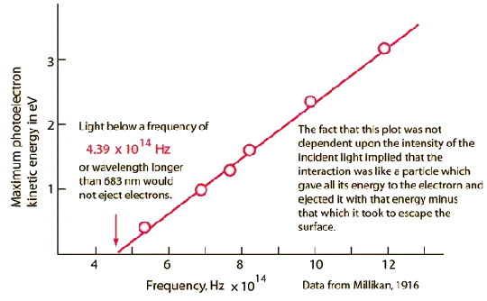

Electrons ejected from a sodium metal surface were measured as an electric current. Finding the opposing voltage it took to stop all the electrons gave a measure of the maximum kinetic energy of the electrons in electron volts.
photoel
The minimum energy required to eject an electron from the surface is called the photoelectric work function. The threshold for this element corresponds to a wavelength of 683 nm. Using this wavelength in the Planck relationship gives a photon energy of 1.82 eV.

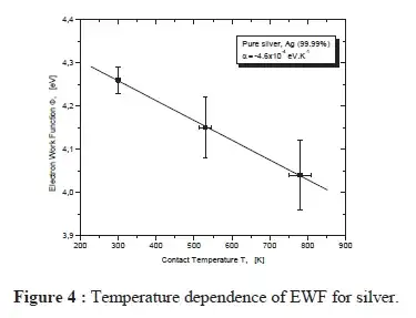

As this paper shows, the work function will change with temperature
workfun
The results for pure silver metal show an evolution of the work function with temperature; a decrease of this parameter of about 0.2 0.3 eV is observed when the cathode temperature reaches 700 K, independently of the nature of the material. The obtained results are rather approximate. This method is not very accurate at higher temperature, because above 700 K the thermionic current dominates and the measurements of the photoelectric current are falsified by large fluctuations
In this sense , if the frequency is below the frequency of the work function by a tiny amount, the rising of the temperature from the absorbed photons will push the fermi level energies high enough so that the photoelectric effect can appear.
