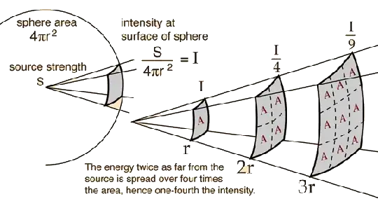

The reason that you can see objects close to the candle but not far away is the inverse square law. inverse square law (source: http://hyperphysics.phy-astr.gsu.edu/hbase/Forces/imgfor/isq.gif)
The candle emits (approximately) an equal number of photons in each direction. If an object is very close to the candle nearly all photons emitted in the direction of this object will hit it and be reflected. However, if the candle is far away, the number of photons per unit area gets smaller and smaller because the number of photons emitted in this direction is constant but the area becomes larger. Thus, an object far away is hit by much less photons. Then, the photons are either absorbed or reflected in all directions and while some travel into the direction of your eye, the inverse square law becomes important again. Hence, in the end, only very few photons are reflected by the corner and reach your eye and you can't see it.
