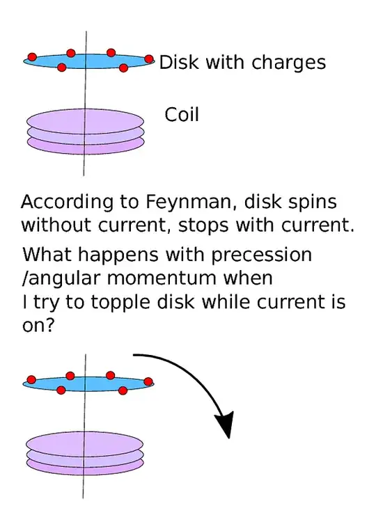

What I dont understand is the following scenario: Suppose you were to use the contraption as described as a gyroscope: Start with a spinning disc with high angular momentum. Now stp this disc with a strong electro magnet. Assume they are both fixed to the same steel rod. Now as long as the no current is flowing and the disc is spinning it is very hard to topple the device due to precession. But as soon as the electricity is flowing there should be no more precession(?) and you can topple the device and switch the electricity off again and have the disk spinning.
Obviously that cannot happen because you would have changed the angular momentum completely with very little torque. So my question is what happens when I would try to do that?
Edit: Here a simple illustration of what I try to do: Trying to topple disk
In the case you are suggesting, you have the disk spinning fast to generate high angular momentum (in the Z direction), which makes it hard to topple the disk axis. Then you apply current to the coil strong enough to stop the disk from spinning, which makes it easy to topple the disk axis.
This example, in no way, violates conservation of momentum, because by stopping the disk, you eliminate the angular momentum (in the Z direction), thereby making it easy to "topple" the disk axis.
This is very similar to the standard gyroscope experiment in a physics class, the only difference is that you have a different method of making the disk spin and stopping it.

My suspicion is that the current change within the coil induces a torque pair that results in the disk slowing down while the coil begins to rotate if free in space. The total angular momentum is conserved as well as any gyroscopic behavior. If the coil is fixed due to a mechanical connection to the earth then the momentum of the disk will be transferred to the earth. In either case the total system momentum should be conserved.
