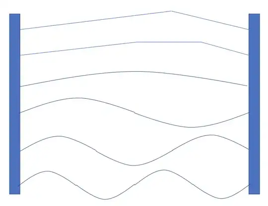

A picture might help:
From top to bottom: a string about to be plucked, the same string a moment later, and the first four fundamental modes of the string.

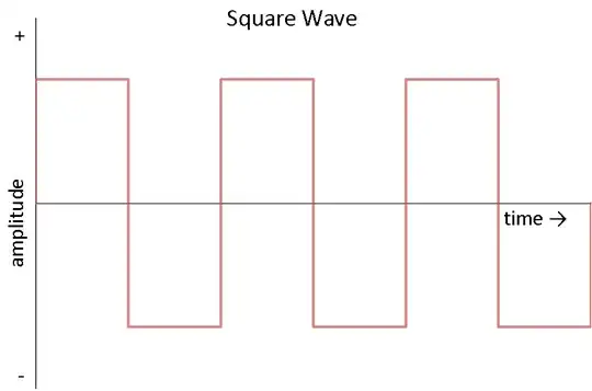

Here is a graph composed of straight lines.

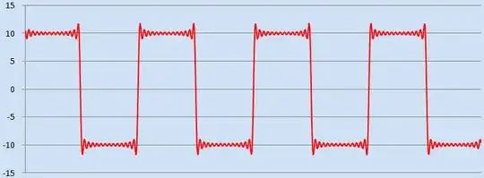

In 1807, Joseph Fourier said (in effect, not literally) that he could make a copy of the above graph, but using curved lines, like these below.

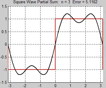

His "trick" was to start with the basic curve above, and then add harmonics of it, waves that resembled the original curved line above, but with various fractions, (harmonics) that, when added together in the right way, would eventually result in this below:
Image Source: Computing Harmonics
If you keep adding more and more waves, you eventually get your straight-ish graph back again. Magic.....
