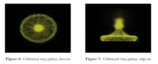

This is one of the set of images from this paper below.
Abstract:
The ΛCDM standard cosmological model is strongly supported by multiple lines of evidence, particularly from observations at large scales such as the CMB and large scale structure. There are some indications, however, of problems at smaller scales. An alternative to the CDM approach is to modify the gravitational force, as exemplified by the MOdified Newtonian Dynamics (MOND) idea. While evidence suggests MOND cannot account for dynamics at all scales without dark matter, it has been successful at galactic scales. Due to the complexity of the theory, however, most tests of MOND have extended no further than using a simple scaling relation to determine rotation curves or velocity dispersions. Therefore, to test the concept more thoroughly we require numerical simulations. We discuss the development and testing of a new N-body solver, using two distinct formulations of MOND, that is incorporated into the RAMSES code. The theory of MOND as a modification of Newtonian gravity is briefly summarised. We then show how it is implemented in the code, providing an example of an idealised test case and future applications.
My apologies for not being able to provide you with a direct link, my android tablet will not copy the link,but if you search for:
Numerical simulations of Modified Newtonian Dynamics G N Candlish , R Smith, and M Fellhauer, you should find it easily.
One possible drawback to this simulation is that the paper is 5 years old, and the number of elements plotted may be less than is possible today. The authors do point out the limitations of their method.
