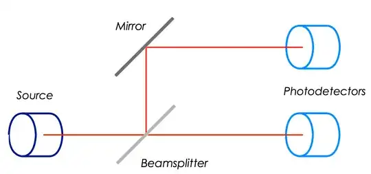

The trick is to use a beam splitter, i.e. a half-silvered mirror. A classical light wave incident on the mirror will see half its intensity reflected and the other half transmitted. The very definition of a photon is that it cannot be split. Thus a single photon will either be reflected, or be transmitted, but never go both ways at once. Moreover to match the intensity law, the probabilities shall be 50/50 for the two paths. An experimental setup can be sketched as follow.

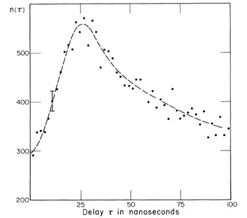

The photodetectors are fast enough to precisely record the time of detection. One then plots the number of clicks in one detector and the other as a function of the delay $\tau$ between the clicks. We expect the count to fall toward zero as $\tau$ goes to zero if we truly have a single photon as it cannot end up in both detectors at once. Conversely, as $\tau$ increases, we expect to see this number of clicks rising as the time window becomes large enough for two or more successive photons to hit different detectors. This is exactly what experiments shows. Here is a plot from [KDM77]
The dip near $\tau=0$ is called the anti-bunching effect. The value zero is not reached because there is an experimental uncertainty on the delay, which therefore is never truly zero. Thus, in effect, there is never only one photon in the experimental setup. This experiment rules out a pure wave theory of light for the reason given in the opening of this answer: the impossibility to explain why we do not get coincident clicks independently of the delay since half of the wave would take each path and each half would hit its respective photodetector at the same time. On the contrary, the result is clearly predicted if there are quanta of light.

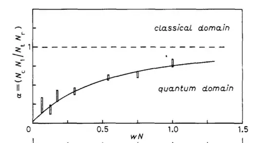

So they plotted the ratio $\alpha$ of the two sides of this inequality
$$\alpha = \frac{N_cN}{N'N''}$$
versus the number of hits $Nw$ during the opening of the gate by A. A quantum mechanical description predicts that $\alpha$ goes to 0 as $Nw$ goes to 0, as we have just explained. Here is their result:
![enter image description here
The dotted line is the classical limit $\alpha=1$, the curve the full quantum mechanical prediction taking into account all the experimental details, and the bars the measurements. Very clearly, the classical behaviour is ruled out whereas the quantum mechanical one is supported by data.
