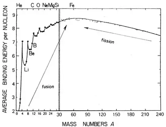

There is no fundamental reason the reaction can't happen. The reaction $Li~+~He~\rightarrow~B$ is however not energetically that favorable. In a supernova core fusion of elements into the actinide series can happen, but they are endothermic. Fusion processes that generate nuclei with an odd number of nucleons tend as a rule not to be as energetically favorable. The binding curve of energy permits one to see this somewhat for low mass elements.
