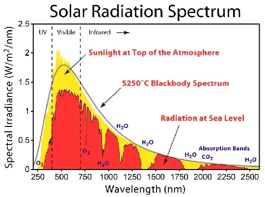

Here's a handy chart from Wikipedia showing the difference between the amount of solar energy hitting the top of the atmosphere (yellow) vs. the amount that makes it to sea level (red):
To estimate the total energy (per area) over a range of wavelengths, look at the area under the curve between these two wavelength. Eyeballing this graph, I would say that approximately 1/3 of the visible light energy is lost, about 3/4 of the UV light energy, and no more than about 1/4 of the infrared light energy.
I should note some technical details: The amount of solar energy that makes it to the earth's surface depends on a lot of factors, particularly the density of air molecules in the atmosphere (which is affected by atmospheric pressure & temperature), the amount of water vapor present, the amount of ozone present, aerosol pollutants, etc. The red spectrum above represents an average over the course of a year at a typical latitude in the continental USA. As far as I can tell, it does not account for cloud cover when taking this average; in other words, this would be an average for a clear day with a typical amount of water vapor, ozone, and aerosols in the atmosphere above you. You can read about the nitty-gritty details here if you're interested.
