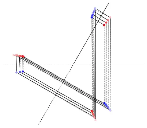

For comparison, this is how the method of images works with two half-planes at a 60° angle, with some artificial offset added to show how the image charges return to each other so that you only need six charges in total:

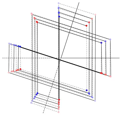

Now consider the case where the planes are angled at 72°:
Note that the sign of the image charges is steady, but that you're required to add an image charge, of opposite sign to the initial point, that's within the sector you're solving for. That tells you that the method of images can help you solve for situations where you start off with two symmetrically-placed charges of opposite sign (or, equivalently, with a sector angle of 36°), but if you don't then the method will introduce a singularity in a region you do care about (as opposed to the even-partitions case, where you add a bunch of singularities in regions that are not of your concern).
This also explains what likely went wrong with your calculation: with this type of procedures, it is very tempting to take the initial charge at the center of the sector, but that should generally be avoided: in this case, for example, the unwanted image charge overlaps with your initial charge if the latter is in the middle of the sector, but that is not the generic behaviour. Instead, it is normally best-practice to start with some non-symmetric configuration so that you can get a better idea of what happens for generic inputs.
