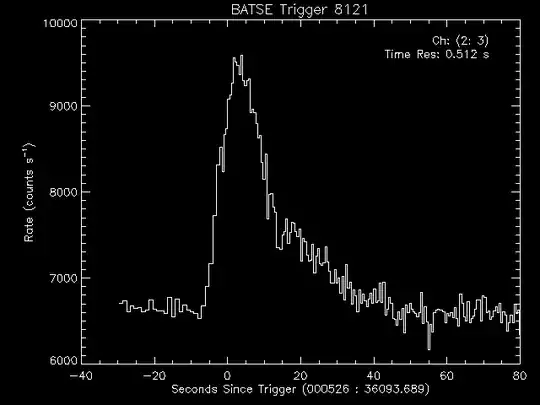

Observations are not made with a single photograph frame, they're made over longer periods of time (for example, a friend takes observations of Herbig stars over 2 minute periods in the J-band with Gemini North). The emissions from stars range from UV to IR (depending on your opinion, it could also range from IR to UV ;) ), these emissions are continuous (though periodic variances can be observed, hence the term "variable stars", but we'll ignore that class for now), so taking an observation now should give you (roughly) the same data any time later
Gamma-ray bursts, on the other hand, last for no more than 10 seconds (this type are called long-duration GRBs with short-duration GRBs taking less than 2 seconds) and then disappear (quiescence)--there are a class of objects called soft-gamma repeaters (SGR) that periodically (albeit irregularly) emit gamma-ray bursts, but not at the same flux as traditional GRBs, so they're not quite the same thing1. Below is an example of a long-duration GRB light curve which shows how quick/efficient observations of GRBs need to be,
enter image description here (source)
Side note: The above is actually the last GRB detected by the BATSE detector on the Compton Gamma-ray observatory (CGRO) before it went offline in 2000.
