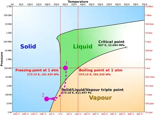

What is going on, considering the concrete case of a chamber, is:
  • initially there is air and some liquid water at room conditions (1);
  • the chamber is then evacuated and pressure drops below the boiling point;
  • the water looses energy through ebullition and evaporation, and freezes (2).
Water phase diagram
Original picture source: Cmglee, https://commons.wikimedia.org/w/index.php?curid=34865054

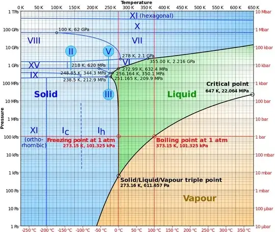

edit: This phase diagram for water from here shows that by moving from atmospheric pressure at 100 kPa down to about 600 Pa, the freezing point and boiling point of water converge to the same temperature. Near this point, the boiling of the water removes enough heat to cool the rest of the water enough for it to freeze. That point at which all three phases can exist at the same time is called the triple point.
