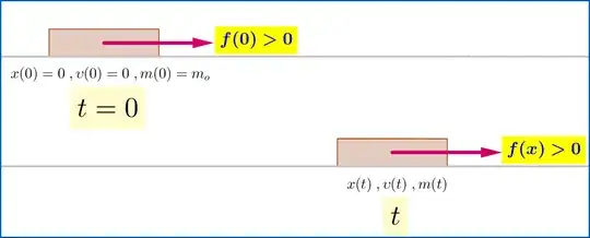

Let a 1-dimensional force continuous, bounded and integrable
\begin{equation} 0<f\left(x\right)<+\infty\:, \qquad 0<\int\limits_{\xi=0}^{\xi=x}f\left(\xi\right)\mathrm{d}\xi<+\infty\:, \qquad\forall x \in \mathbb{R}^{+} \tag{01} \end{equation} acting on a particle initially at rest on the origin with rest mass $\;m_{0}$, see Figure. On one hand we have \begin{equation} \mathrm{d}\left(mc^2\right)=f\left(\xi\right)\mathrm{d}\xi=\mathrm{d}\mathrm{W}\left(\xi\right) \tag{02} \end{equation} so integrating and considering the initial conditions \begin{equation} m\left(x\right)=m_{0}+\dfrac{1}{c^{2}}\int\limits_{\xi=0}^{\xi=x}f\left(\xi\right)\mathrm{d}\xi=m_{0}+\dfrac{1}{c^{2}}\mathrm{W}\left(x\right) \tag{03} \end{equation} where \begin{align} \!\!\!\!\!\!\!\!\!\!\!\!W(x) & =\int\limits_{\xi=0}^{\xi=x}f\left(\xi\right)\mathrm{d}\xi=\text{work done by force $f(x)$ from $0$ to $x$} \quad [W(x)> 0\:\: \forall x>0] \\ &=\left(m-m_{0}\right)c^{2}=\text{kinetic energy of the particle} \tag{04} \end{align} and on the other hand \begin{equation} f=\dfrac{\mathrm{d}p}{\mathrm{d}t}=\dfrac{\mathrm{d}\left(mv\right)}{\mathrm{d}t} =m\dfrac{\mathrm{d}v}{\mathrm{d}t}+v\dfrac{\mathrm{d}m}{\mathrm{d}t} \tag{05} \end{equation} so \begin{equation} f\left(x\right)\mathrm{d}x=\frac12 m\,\mathrm{d}v^{2}+v^{2}\mathrm{d}m \tag{06} \end{equation} Replacing in (06) the term $\,\mathrm{d}m\,$ by its expression from (02) \begin{equation} f\left(x\right)\mathrm{d}x=\frac12 m\,\mathrm{d}v^{2}+\dfrac{v^{2}}{c^{2}}f\left(x\right)\mathrm{d}x \tag{07} \end{equation} so \begin{equation} \dfrac{f\left(x\right)\mathrm{d}x}{m}=\frac12\dfrac{\mathrm{d}v^{2}}{\left(1-\dfrac{v^{2}}{c^{2}}\right)} \tag{08} \end{equation} Inserting the expression (03) for $\,m\,$ and replacing $\,f\left(x\right)\mathrm{d}x \rightarrow \mathrm{d}\mathrm{W}\left(x\right)\,$ we reach the following differential equation with respect to the separated variables $\,x\,$ and $\,v^{2}\,$ \begin{equation} \dfrac{\mathrm{d}\mathrm{W}\left(x\right)}{\left[m_{0}c^{2}+\mathrm{W}\left(x\right)\vphantom{\frac12}\right]}=\frac12\dfrac{\mathrm{d}\left(\dfrac{v^{2}}{c^{2}}\right)}{\left(1\!-\!\dfrac{v^{2}}{c^{2}}\right)} \tag{09} \end{equation} or \begin{equation} \dfrac{\mathrm{d}\left[m_{0}c^{2}+\mathrm{W}\left(x\right)\vphantom{\frac12}\right]}{\hphantom{\mathrm{d}}\left[m_{0}c^{2}+\mathrm{W}\left(x\right)\vphantom{\frac12}\right]}=-\frac12 \dfrac{\mathrm{d}\left(1\!-\!\dfrac{v^{2}}{c^{2}}\right)}{\hphantom{\mathrm{d}}\left(1\!-\!\dfrac{v^{2}}{c^{2}}\right)} \tag{10} \end{equation} that is \begin{equation} \mathrm{d}\left(\ln\left[m_{0}c^{2}+\mathrm{W}\left(x\right)\vphantom{\tfrac12}\right]\vphantom{\frac12}\!\!\right)= \mathrm{d}\left[\ln\left(1\!-\!\dfrac{v^{2}}{c^{2}}\right)^{-\frac12}\vphantom{\frac12}\!\!\right] \tag{11} \end{equation} Considering the initial conditions the integration of (11) yields \begin{equation} m_{0}c^{2}+\mathrm{W}\left(x\right)=m_{0}c^{2}\left(1\!-\!\dfrac{v^{2}}{c^{2}}\right)^{-\frac12} \tag{12} \end{equation} From equations (12) and (03) \begin{equation} m\left(\upsilon\right)=\dfrac{m_{o}}{\sqrt{1-\dfrac{\upsilon^{2}}{c^{2}}}} \tag{13} \end{equation} while solving (12) with respect to $\,v\,$ we have its following expression as function of $\,x\,$ \begin{equation} v\left(x\right)=c\sqrt{1\!-\!\left[\dfrac{m_{0} c^{2}}{m_{0}c^{2}+\mathrm{W}\left(x\right)}\right]^{2}} \tag{14} \end{equation} Since $\,\mathrm{W}\left(x\right)\,$ is a positive increasing function of $\,x\,$ and \begin{equation} \lim_{x\rightarrow +\infty}\mathrm{W}\left(x\right)=+\infty \tag{15} \end{equation} we have \begin{equation} \lim_{x\rightarrow +\infty}v\left(x\right)=c \:, \qquad 0<v\left(x\right)<c \quad \forall x \in \mathbb{R}^{+} \tag{16} \end{equation}
If we want to find the position as function of time, that is $\,x\left(t\right)\,$, then from equation (14) given that $\,v\left(x\right)=\mathrm{d}x/\mathrm{d}t\,$, we have after separation of the variables $\,x\,$ and $\,t\,$ \begin{equation} \left(1\!-\!\left[\dfrac{m_{0} c^{2}}{m_{0}c^{2}+\mathrm{W}\left(x\right)}\right]^{2}\right)^{-\frac12}\mathrm{d}x=c\,\mathrm{d}t \tag{17} \end{equation} To have analytic solution depends upon the possibility of analytic integration of the function of the lhs of (17).
For example in case of constant force, $\,f\left(x\right)=f_{0}>0 \quad \forall x \in \mathbb{R}^{+}\,$, the analytic solution is(1) \begin{equation} x\left(t\right)=\dfrac{m_{o}c^{2}}{f_{0}}\left[\sqrt{1+\left(\dfrac{f_{0}t}{m_{o}c}\right)^{2}}-1\right] \tag{18} \end{equation}
