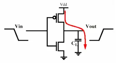

The processor contains millions of complementary FETs as shown. When the input goes low the small capacitance gets charged and it will hold a small amount of energy. A same amount is lost during the charging. When the input goes high again the charge will be drained to ground and be lost. So with each level change $n$ Joules are lost. If the frequency is 1 MHz then this switching occurs 10$^{6}$ per second, and $n$ 10$^{6}$ Joules will be lost per second. If the frequency is 1 GHz that loss will be $n$ 10$^{9}$ Joules.
Notice that the energy in a capacitor is $\frac{C \cdot V^2}{2}$, so the dissipation varies quadratic with voltage; running the processor at half the voltage will reduce power with 75 %.
This leads to the equation tuğrul also mentions:
$ P = c \cdot V^2 \cdot f + P_S $
where $c$ is a scaling constant, with the dimension of capacitance (F). $P_S$ is the static power dissipation Martin refers to, which is the power at a zero clock frequency.

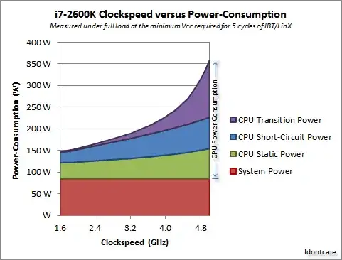

To add to the "linear with frequency" point, there is also an additional factor. As that "dynamic power" increases, the temperature of the die will increase and this will also increase the leakage current through the millions of transistors, which will cause more dissipation (termed "static power")
There's a long Anandtech thread taking lots of values and pulling them apart into their static and dynamic contributions which results in the following graph: http://i272.photobucket.com/albums/jj163/idontcare_photo_bucket/Intel%20Core%20i7-2600K/i7-2600KPower-ConsumptionAnalysis.png
The slight kick up in static power at higher clock speeds is (as I understand it) as a result of the higher die-temperature.
