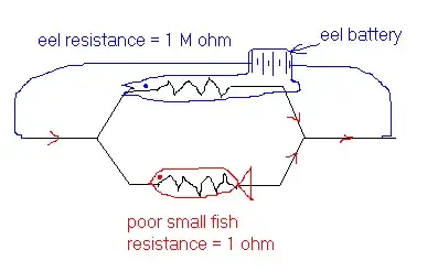

alt text Suppose current entering into this parallel circuit is $10A$
then almost all the current flows through poor small fish's body
current through poor small fish's body = $10A \times \frac{1M}{1M+1} \approx 10A $
This is probably the large picture but I am just guessing. Hope its correct.
