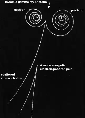

gamma interactions
In this photo in a bubble chamber gammas are entering from the top and here one has interacted with an atomic electron scattering it away and generated an e+e- pair and a secondary photon, the whole first vertex conserves energy and momentum. We know the existence of the secondary photon because a second e+e- pair was by an interaction with an electron or a nucleus where the transfer of energy to the target was too small to appear in the photo.
So this is experimental evidence that photons travel.
As a particle at that level it is also a wave, and there exist consistent derivations of the formation of the classical wave from a large ensemble of photons.
For mathematical consistency, photons also travel in vacuum at speed c.
