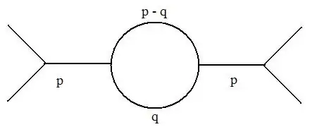

The difficulty with the renormalization of gravity can be seen in the following argument. The main difficulty lies with loops. We consider the following loop enter image description here
In this diagram we have vertices $V~\sim~p^2$ and internal lines $\sim~1/p^2$ and the loop with $O~\sim~\int d^4p$. The degree of divergence (the exponent on divergence) gives the $D~=~2V~-~2L~+~4O$ The Euler characteristic for this graph is $1~=~V~-~L~+~O$ or that $2(V~-~L)~=~2~-~2O$ so that $D~=~2(1~+~O)$. This means the divergence increases without limit as the order of the diagram increases.
We might though suppose that the order of these loop diagrams cuts off at one. We then have the integration from $k~=~0$to $k~=~1/\ell_{p}$, for $\ell_p~=~\sqrt{g\hbar/c^3}$ $=~1.6\times 10^{-35}m$ the Planck length. The divergence is then order $4$ or $\simeq~10^{140}m^{-4}$. The expected cosmological constant would then be $\Lambda_p~\simeq~10^{70}m^{-2}$ this is $122$ orders of magnitude larger than the measured cosmological constant.
