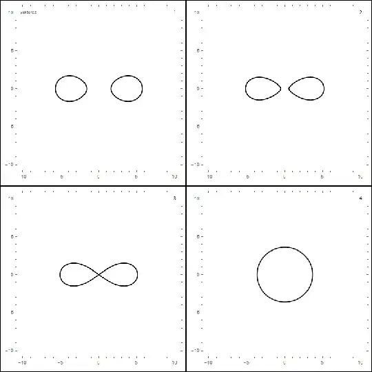

Supplementary question: What is the shape of each of the event horizons prior to coalescence?

For a picture of the shapes of the horizons, see http://arxiv.org/abs/gr-qc/0610122 Fig 1.

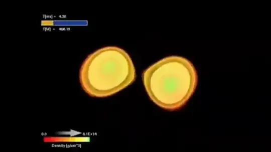

The electromagnetic field is extreme, growing to 10$^{16}$ times that of Earth. Is your rocket non-magnetic; what about the electronics on board. There's a long of interaction between the two objects prior to their collision, a fight to see whom can rip the skin off of the other.
The dance of two quasars
Here is a NASA Goddard video showing the results of 6 weeks of supercomputer time used to model the last few microseconds of their life and the events leading up to it: https://www.youtube.com/watch?v=ow9JCXy1QdY or a simulation showing density on the left and magnetic field on the right: https://svs.gsfc.nasa.gov/vis/a010000/a010700/a010740/3mag.bns.01.mov and https://svs.gsfc.nasa.gov/vis/a010000/a010700/a010740/jetformation_02_med.mov .
More info about the modeling of this event is on this webpage: "The engine that powers short gamma-ray bursts", for high resolution stills see: "When Neutron Stars Collide", and an earlier paper: "On the black hole species (by means of natural selection)" where the author explains that the exact topology of multiple black holes in higher dimensions is not well understood.
The function is called pair of pants, see reference 1 and reference 2, which basically looks like this:
