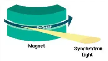

Elementary charges (electron, proton and their anti-particles) in unbounded state have unchangable charges and by this electric fields of certain size.
Charges emit EM radiation in the case of accelerations. This acceleration can be a spiral path induced by a magnetic field or be this during the deflection from an electric field.
Synchrotron radiation .............................................................Bremsstrahlung

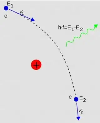

But there is one more detail. During the approach to the nucleus the electron emits EM radiation, called spontaneous emission. The energy for the emission has to come from somewhere. Now your point of a changing electric field come into play.
What if the electric fields of the electron and the proton inside an atom get weaker during the approach of the electron towards the nucleus? The excess energy wil be realized in the form of EM radiation.
