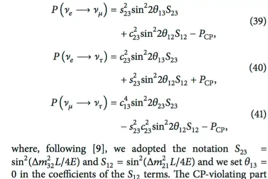

I was reading various reviews on neutrino physics but I couldn't understand the following to complete satisfaction.
How is $\theta_{12}$ identified with the Solar mixing angle and $\Delta m^2_{21}$ the Solar mass-squared difference?
The formulae for three-flavor oscillation probabilities, in general, depends on all three mixing angles $\theta_{12},\theta_{23}$ and $\theta_{13}$:
$$P_{\alpha\rightarrow\beta}=\delta_{\alpha\beta} - 4 \sum_{i>j} {\rm Re}(U_{\alpha i}^{*} U_{\beta i} U_{\alpha j} U_{\beta j}^{*}) \sin^2 \left(\frac{\Delta m_{ij}^2 L}{4E}\right) \\ + 2\sum_{i>j}{\rm Im}(U_{\alpha i}^{*}U_{\beta i}U_{\alpha j} U_{\beta j}^{*}) \sin\left(\frac{\Delta m_{ij}^2 L}{2E}\right).$$
It's not clear to me why only one mixing angle be associated with solar neutrino oscillation. An answer starting from the three-flavour oscillation formulae will be helpful for my understanding.

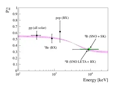

2014 Borexino graph

what about the solar mixing angle and mass squared splitting
Yes, you say, but why are $\theta_{12}$ and $\Delta m_{12}^2$ associated with solar neutrino flavor change when the general equations involve three mixing angles, three square mass splittings?
As we mentioned above, there are two regimes in the Borexino graph (Fig 84 above) of experimental observations of solar $\nu_e$ survival fractions (three if you count the transition region between the two, the predicted upturn from the low $P_{ee} \approx 0.3$ around $10 \, \mathrm{MeV}$ neutrino energy, to nearer $P_{ee} \gtrsim 0.4$ at $5 \, \mathrm{MeV}$ as the MSW effect begins to turn off, apparently reported for the first time by Super-Kamiokande at Neutrino2020).
the low energy region
We detect about $0.55$ of the expected low energy (expectation $\langle E_{\nu}\rangle \sim 267 \, \mathrm{keV}$) electron neutrinos from $pp$ fusion and subsequent $\beta^+$-decay: $$p + p \rightarrow \; ^2_1\mathrm{H} + e^+ + \nu_e $$ ($^2_1\mathrm{H}$ is deuterium, i.e., one proton $+$ one neutron, resulting from $\beta^+$ decay of the initial diproton $p+p$ fusion.)

how do we end up with survival probability dependent on only the $\theta_{12}$ angle?
$pp$ neutrino flavor oscillations therefore occur in the Sun as in vacuum (no significant level jump probability either, but we will not get into that here). Now, since we cannot observe solar neutrino oscillations at Earth (for the reasons discussed earlier), we may only observe average flavor change. For the solar $pp$ $\nu_e$, PDG offers a two-neutrino model survival probability equation: $$ \bar{P}^{2 \nu} (\nu_e \rightarrow \nu_e) \simeq 1 - \frac{1}{2} \sin^2 2 \theta_{12} \tag{14.89} $$
We obtain $\bar{P}^{2 \nu} (\nu_e \rightarrow \nu_e) \simeq 0.5766$ for $\theta_{12} = 33.48^{\circ}$ with this equation.
Aha! We see the low energy solar neutrino survival probability (the left side of the Borexino graph above, $P_{ee} \approx 0.55$) is dependent solely on the $\theta_{12}$ mixing angle. Why is this true when there are three mass splittings and three mixing angles?

the high energy region
On the right side of the Borexino graph above we see the survival probability $P_{ee}$ observed by various experiments is $\sim 0.3$ in the $10 \, \mathrm{MeV}$ area (this is the sweet spot for the SNO experiment, though the threshold is lower). The solar neutrinos in this range are predominantly produced in the $\beta^+$ decay from $^8_5\mathrm{B} \rightarrow \; ^8_4\mathrm{Be}^* + e^+ + \nu_e$ with energy expectation $\langle E_{\nu}\rangle = 6.735 \, \mathrm{MeV}$.
This $0.3$ survival probability is very close to simply $\sin^2 \theta_{12} = 0.304$ for $\theta_{12}=33.48^{\circ}$. Why is $\theta_{12}$ again so closely connected to an observed survival probability of solar neutrinos?
The $\Delta m_{12}^2$ oscillation length for a $10 \, \mathrm{MeV}$ neutrino is $\sim 330 \, \mathrm{km}$ (about $\sim 10 \, \mathrm{km}$ for the $\Delta m_{13}^2$ split), again much smaller than the distance from the Sun to Earth, so detecting oscillations would again be impossible on that basis alone (and the averaging over the region of neutrino production in the Sun, $\Delta R \simeq (0.04 \text{-} 0.20)R_{\odot}\simeq 10^5 \, \mathrm{km}$ as we mentioned earlier). However, there is a much more significant feature for a $10 \, \mathrm{MeV}$ solar neutrino, i.e., the matter potential.
