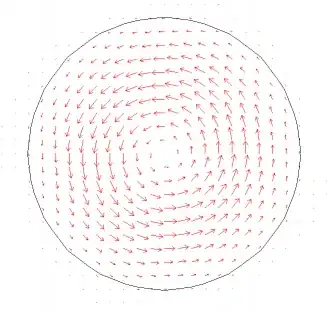

Following on from this, what part of the field then defines the modal polarization. e.g. on p76 of the lecture notes cited above the field for TE01 is shown to exhibit a 'swirling pattern' as follows:
Is this related to the real part of the modal amplitudes? Or the magnitude (i.e. if we converted to cartesian coordinates, this would be found by adding the square of X and Y terms in quadrature?)

As usual, whenever you have a complex-valued amplitude $\tilde{\mathbf{E}}(\mathbf r)$, it's a stand-in for a physical field that's obtained as its real part, i.e. $$ \mathbf E(\mathbf r,t) = \mathrm{Re}\left( \tilde{\mathbf{E}}(\mathbf r)e^{-i\omega t}\right). $$ The presence of nontrivial imaginary parts of $\tilde{\mathbf{E}}(\mathbf r)$ signifies nontrivial phase relations between the electric field when taken at different points. This is obvious with e.g. trivial factors of the form $e^{ik_zz}$, but it's all the same whenever the amplitude is complex. Thus, for example, if $\tilde{\mathbf{E}}(\mathbf r)=E_0(\hat{\mathbf e}_x+i\hat{\mathbf e}_y)$, then $$ \mathbf E(\mathbf r,t) = E_0\left(\cos(\omega t)\hat{\mathbf e}_x+\sin(\omega t)\hat{\mathbf e}_x\right), $$ i.e. with a phase of $i=e^{i\pi/2}$ between the two components. Generally, if two scalar amplitudes at two different locations differ by a phase $e^{i\varphi}$, there will be a relative delay of $\varphi/\omega$ in the oscillations of those two components.
The modal polarization is a bit more complicated, and the polarization diagram you've drawn is special in that the polarization is linear everywhere (where in the general case it will be elliptical almost everywhere). The polarization is linear if and only if the complex mode amplitude vector $\tilde{\mathbf{E}}(\mathbf r)$ is real or it is a real vector times a single complex scalar, and in that case the diagram as drawn just represents that real-valued amplitude.
However, in general, complex valued vectors are not of that form (cf. the field from above, $\tilde{\mathbf{E}}(\mathbf r)=E_0(\hat{\mathbf e}_x+i\hat{\mathbf e}_y)$, as an example that cannot be reduced to a real vector times a complex scalar), so if you want to depict the polarization field you need to extract its elliptical axes (via the method in this answer) which are real-valued vectors that you can then draw.
