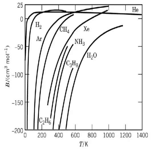

Assuming the virial expansion (which amounts to quite a general equation of state, we have $$ \frac{PV}{NkT} = 1 + B(T)\frac{N}{V} + C(T)\left(\frac{N}{V}\right)^2 + \cdots $$ It follows that $$ \left(\frac{\partial U}{\partial V}\right)_{T,N} = T^2\left(\frac{\partial(P/T)}{\partial T}\right)_{T,N} = kT^2\frac{N}{V}\left(B'(T)\frac{N}{V} + C'(T)\left(\frac{N}{V}\right)^2 + \cdots\right) $$ For gases that are not too dense, we can truncate at the second virial coefficient $B(T)$ term to good approximation, so the sign of this derivative is the same as the sign of $B'(T)$. For many real gases, the second virial coefficient is a monotonically increasing function of temperature (at least for temperatures that are not too high, see diagram below), so $B'(T) > 0$ and thus to good approximation $$ \left(\frac{\partial U}{\partial V}\right)_{T,N} \gtrapprox 0. $$ enter image description here
