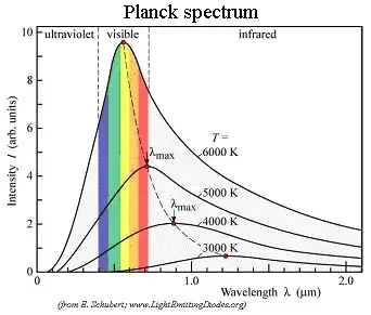

enter image description here Attached is an image from the internet. The suns temperature is around 5800 degrees Kelvin at the surface. The sun is fairly well represented by a blackbody. The blackbody equations were used to generate the curves shown on this image. The curve closest to that of the sun shows a peak near the color yellow as expected. Most of the sun's energy (area under curve) is generated in the infrared wavelength region. The curve decreases as shown so the intensity of radio waves (not shown on image) is very small. The curve essentially goes to extremely long wavelengths but with ever decreasing strength. So yes the sun emits radio waves of every frequency. In projects I've worked on in the past some missiles communicated to ground via radio frequencies. It was determined to be important that antenna was not facing the sun due to interference from suns radio waves. So at least above the atmosphere the small intensifies of radio waves was enough to cause interference. I can't disclose the applicable wave bands.
