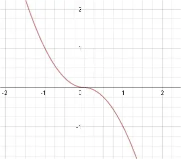

With that said, here's is a graph of the resistive force $F$ as a function of $v$:
Because the sign of the force is opposite that of velocity, the equation can be conveniently written $$F=-v|v|$$
Although this function looks smooth and has a derivative, $2|x|$, it doesn't have a second derivative. Isn't it unusual for a simple equation of a physical phenomenon in classical mechanics to lack a second derivative? It's unintuitive to me that the force doesn't have a second derivative. Physically, it doesn't feel like anything non-smooth is going on.
