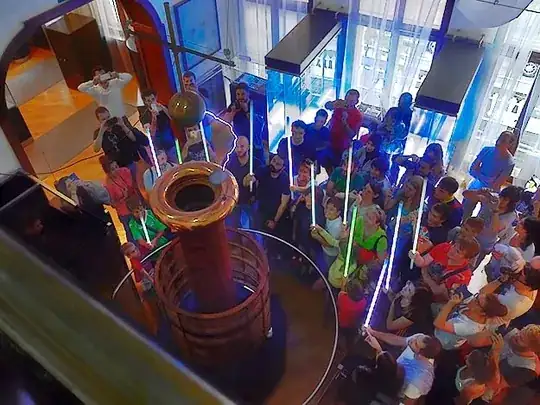

I was recently at the Nikola Tesla Museum in Serbia. I found it a bit lacking on the science aspects of Mr Tesla - but it held a remarkable collection of his personal belongings (he was evidentially an exceptionally well-dressed man).
Anyway one of their exhibits was a Tesla coil which discharged to a grounded sphere (on the ceiling). People were asked to hold fluorescent tubes which glowed. See image from the museum website.
The explanation given at the museum was that the electrons from ionised air travelled down from the "lightning" to the tube, completing the circuit and thus the tubes light up.
Reasons why I think the explanation may be flawed:
  1. The mean free path of electrons is too small in air to travel to the fluorescent tubes. I haven't done the calculations - but I have a feeling of it being on the order of nm to cm - not metres as is required.
  2. The "turn on" was instant when the lightning started - this suggests, for me, that something with the E field is much more likely than charged particles.
  3. Electrons would ionise the air before travelling to the tubes.
  4. The ions/electrons and plasma would be contained very close to the lightning (this is really a restatement of the above points).
So, does anyone have a better explanation?

Addressing each of your remarks below
The Tesla coil is properly classified as a high frequency, air gap transformer. The secondary coil can generate over 1 Million volts, however very low, high frequency current. The reason the tubes light up is that current indeed from this high potential is flowing all around the coil, trying to make its way to ground. In the vicinity of the top load the voltage, energy is great enough to ionize the air and you see streamers. But that doesn't mean there is no electric field, current flow outside of this area. There is still enough potential to excite the zinc sulfide inside the tubes to cause them to glow.
Yes - electrical current travels near the speed of light.
They do in the immediate area of the top load, but the potential field exists beyond this area.
Not true. Even without Tesla coils there are free electrons all around us. The Tesla coil generates more than usual in its vicinity and creates current flows through local antennas (people and tubes).
