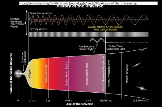

There are B-modes predicted. The inflationary cosmos was a de Sitter spacetime with a large cosomological constant, or really parameter $\Lambda(\phi,~\dot\phi)$. A perturbation on this metric can produce gravitational waves. In the inflating spacetime there are quantum fluctuations of the inflaton field, and these produce vacuum gravitational waves. The image below is animated and should show a circular polarized gravitational wave. Gravitational radiation has two degrees of polarization (helicity = 2) and in general it is circular.
enter image description here After inflation, which the system falls to the lower energy vacuum, or physical vacuum, radiation and matter is generated. This couples with the gravitational radiation just produced in the $10^{-35}$ to $10^{-32}$ second inflationary period. This induces local anisotropies in the observed distribution of matter. The gravitational radiation is converted into acoustical waves with these circular properties. This patter is then left on the CMB at the surface of last scatter.

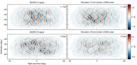

In 2015 the BICEP2 released data indicating this. The data was confident to 6-$\sigma$. The measurements are see in the diagram below. However, it was found that dust in the Milky Way galaxy can induce this circular polarization of photons. Analysis caused the data to fall below 3-$\sigma$ confidence. BICEP3 is from my understanding on line and the enhanced ability should separate out inflationary signal from dust.
