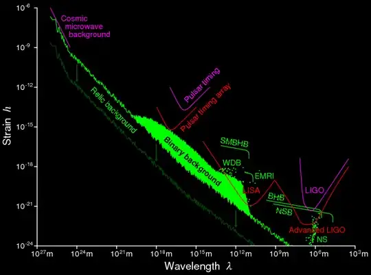

The stresses and strains of a gravitational wave as seen here are those of a quadrupole source. They generate a wave, but the wavelengths are enormous.
gravwavelen
Humans being of orders of meter, and cells of microns and smaller, the energy/amplitude of the classical wave should be enormous in order for a body to be affected as a gravitational wave passes.
An analogy would be the effect on cm stick of wood, floating on a tsounami kilometre wavelength wave.
