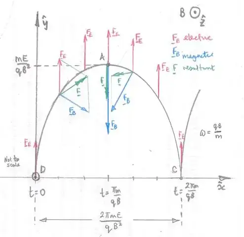

So the trajectory of the charge looks something like this.
The charge starts at position $D$ and has an acceleration in the y-direction due to the electric field.
But as soon as the charge starts moving the magnetic force acts in a direction at right angles to the motion with a component in the opposite direction to the electric field force.
At position $A$ the magnetic force is $2qE$ in the negative y-direction whereas the electric field force is still $qE$.
Then on to position $C$ where the charge stops and the motion is repeated by displaced by $\dfrac{2 \pi m E}{q B^2}$ in the x-direction.
The work done by the electric field in moving the particle from position $D$ to position $A$ is $qE\, \dfrac {mE}{qB^2}$ (the magnetic force is always at right angle to the velocity of the charge) and you can show that this is equal to the kinetic energy of the charge at this position $\dfrac 12 m v_{\rm x}^2$.
