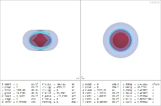

Example of a testparticle being thrown radially upwards with the local escape velocity by a corotating ZAMO sitting close above the horizon at θ=45°:
(The Spin parameter in the animation is a=Jc/G/M²=0.998)
