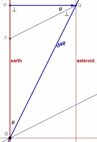

As others have mentioned, a common problem is understanding the meaning of the variables in the formula. [Which is primed? and unprimed? Maybe this notation is ambiguous.]
In my opinion, a spacetime diagram is good way to clarify the meaning of the different variables because one has something more tangible than "carefully-chosen but maybe not-well-understood strings of words or symbols". ("A spacetime diagram is worth a thousand words.")
The answer I offer here elaborates on the earlier answers by using the spacetime diagram, together with rapidities (Minkowski-angles), which suggests helpful analogies with ordinary Euclidean trigonometry. [In addition, given the Euclidean geometry version of this problem, would one use rotation matrices?]
spacetime diagram with rapidities
With time running upwards, we have drawn the worldlines of the earth, the asteroid [at rest with respect to the earth], and the ship that leaves the earth at event O and arrives at the asteroid at event Q.
With the ship velocity $v=(1/2)c$,
the gamma-factor is $\gamma=\frac{1}{\sqrt{1-v^2}}=\frac{2}{\sqrt{3}}=1.1547...$ [in units where $c=1$].
Using rapidities, where $v=\tanh\theta$, we have $\gamma=\cosh\theta$. So, $\gamma=\cosh(\rm arctanh(v))=\cosh(\rm arctanh(0.5))=1.1547...$ (with help from WolframAlpha). The Rapidity-angle is angle between timelike worldlines of the earth and ship, and between their spacelike-directions in this plane.
  • Consider Minkowski-right-triangle OPQ (with hypotenuse $OQ$ and legs $PQ \perp OP$, along the earth's space and time axes). The velocity is $v=\frac{PQ}{OP}$.
    Time-Dilation compares the measured-durations between events O and Q by comparing the (apparent-duration) timelike-leg OP to the (proper-time) timelike-hypotenuse OQ].
    The time-dilation factor arises from $\gamma=\cosh\theta=\frac{ADJ}{HYP}=\frac{OP}{OQ}$. So, $$(\mbox{apparent-duration } OP)=\gamma(\mbox{proper-time }OQ).$$
  • Consider Minkowski-right-triangle QPX (with hypotenuse $QX$ and legs $PX \perp QP$, along the earth's time and space axes).
    Length-contraction compares the measured-distances between two parallel timelike-worldlines by comparing the (proper-length) spacelike-leg PQ to the (apparent-length) spacelike-hypotenuse XQ.
    The length-contraction factor arises from $\gamma=\cosh\theta=\frac{ADJ}{HYP}=\frac{QP}{QX}$. So, $$(\mbox{proper-length }QP)=\gamma(\mbox{apparent-length }QX),$$ or, more traditionally, $$(\mbox{apparent-length }QX)=\frac{(\mbox{proper-length }QP)}{\gamma}.$$
  • With $v=(1/2)$ and $(PQ)=2$,
    $$(QX)=\frac{(PQ)}{\gamma}=\frac{2}{\cosh({\rm{arctanh\ }0.5})}=\frac{2}{2/\sqrt{3}}=\sqrt{3}$$ $$(OP)=\frac{(PQ)}{v}=\frac{2}{1/2}=4$$ $$(OQ)=\frac{(OP)}{\gamma}=\frac{4}{2/\sqrt{3}}=2\sqrt{3},$$ in accord with the answers given earlier.
    Refer to the diagram for a physical interpretation.
