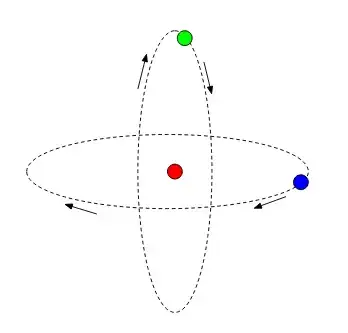

Suppose you consider two satellites orbiting a planet with their orbits aligned at right angles:
satellites
This arrangement of the three objects produces a three dimensional object, even with just three points, because the plane formed by the three objects continuously changes its orientation in 3D space.
The above shows that even for a purely classical system three objects can define a 3D structure. For completeness we should point out that quantum objects, like quarks in a nucleus or electrons in an atom, are not points and do not have a position in the sense that a classical object has a position. Quantum objects are delocalised in space, a bit like a fuzzy cloud, so they are inherently three dimensional. A hydrogen atom does not consist of a pointlike electron orbiting in a plane around the proton. The electron in a hydrogen atom is a fuzzy 3D blob centred on the proton.

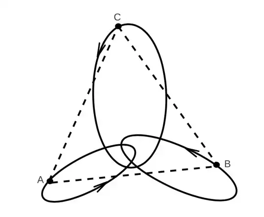

I just want to complement on this answer in the classical case where your conclusion would not hold either. For example, Lagrange found in 1772 a family of solution where all three point particles do not move in the same plane. A detailed derivation can be found in Danby (1988). Here is what it looks like, where A, B, and C are the position of the three point particle:
All orbits are ellipses and ABC remains an equilateral triangle throughout.
Many more, way more complex, periodic orbits have been discovered since then. You can find a nice review in Musielak and Quarles (2014). Even if you don't want to or can't follow the math, there are plenty of nice illustrations, see for example figure 3.
So the only question, really, is the stability of such non-coplanar orbits and whether they will eventually become coplanar. Most of the studies of 3-body motion I know of concentrate on a system where one mass is enormously bigger than the others (the Sun, of course). With three equal masses as in your case, I must admit I do not know.
