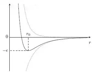

The motion of a massive particle under the inverse square force is also determined by its energy but also by its angular momentum. The solid line in the plot bellow shows the effective potential as a function of the distance $r$ to the centre of force. That potential looks that way because angular momentum is conserved and rotational kinetic energy behaves as a repulsive potential energy, the so-called centrifugal potential.
The minimum energy a particle can have is $-\epsilon$. This corresponds to constant $r=r_0$ and you can think of this circular motion as a sort of dynamic equilibrium. In order to increase planet's energy one needs to give it some impulse. No matter the direction of this impulse, the planet will tend to move out of its circular motion and therefore change $r$. This change cannot be arbitrary though. Energy conservation shows that for mechanical energy $-\epsilon <E<0$, the value of $r$ lies in the interval $r_{\mathrm{min}}\leq r\leq r_{\mathrm{max}}$. The orbit therefore can no longer be a circle, the radial distance oscillates. Since potential energy changes, kinetic energy and velocity also change. In fact, $r_{\mathrm{min}}$ and $r_{\mathrm{max}}$ correspond to the semi-minor and semi-major axes of the ellipse. However, a simple energy diagram is not enough to show the motion is actually an ellipse. This can be obtained by solving Newton's second law in the form of the so-called Binet equation or exploring the conservation of the Runge-Lenz vector.
As you can see, a circular orbit is actually a very special orbit in the sense that the particle must have the exact energy $-\epsilon$. It is therefore statistically more probable that during a bounded orbit formation, the orbit be be non-circular, i.e. elliptical.
