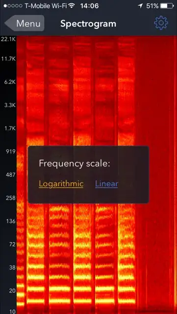

You don't sing a single pitch - you sing a frequency and its harmonics. Using a simple spectrum analyzer, this is me "singing" the letter A and M, alternately (AMAMA, actually):
The letter "A" is the one with more harmonics (brighter lines at higher frequencies), the letter "M" seems to have a bigger second harmonic. The frequency scale is not calibrated correctly (cheap iPhone app...)

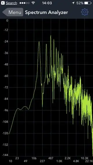

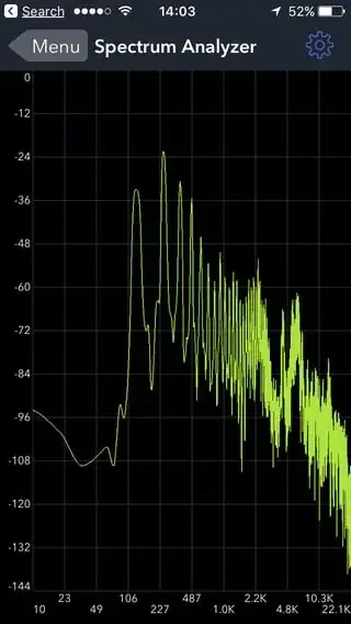

Here are two other shots, side by side (M, then A). You can see that the 2nd harmonic of the M is bigger than the first; by contrast, the higher harmonics from the A are dropping off more slowly: enter image description here enter image description here
Simple vowels have this in common: the shape of your mouth changes the relative intensity of harmonics, and your ear is good at picking that up. Incidentally, this is the reason that it is sometimes hard to understand what a soprano is singing - at the top of her range, the frequencies that help you differentiate the different vowels might be "out of range" for your ears.

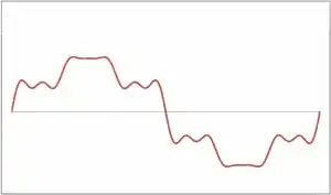

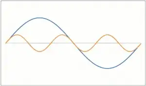

Here are two pictures to illustrate what I mean:
Both of them have the same amplitude, or volume.
Both of them have the same perceived frequency, or pitch.
Thus both of them play the same musical note we perceive.
But looking at the wave form, you could probably tell that they will sound differently, even though we would perceive them as the same note.
This difference is similar to a piano C3 vs a guitar C3.
Essentially: The same perceived frequency and air pressure creates the illusion of the same musical note perceived by a listener. Completely different wave forms (sounds) can be perceived as the same musical note, as long as their wave form "look the same" (the two pictures above illustrated what I mean with that).
