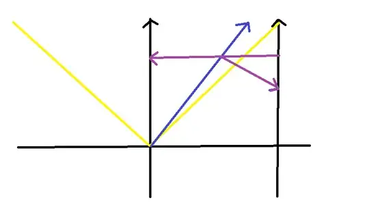

EDIT 2: Graph I made enter image description here In the horrbible graph above we have Earth and AC time lines (black), the realtivistic ship time line (blue) and near istantaneous FTL communications (purple). The first message is sent from AC to Earth, from their point of view is istantaneous, but from the point of view of the ship is going back in the past. When they receive it they sent a message back to AC (purple line perpendicular to blue line). Again this message is istantaneous from their POV, but from AC POV it arrives before it is sent. So AC receive an answer to a message that they haven't sent yet. What did I do wrong ?

I guess the source of your confusion is that you suppose that "time lines" (dots on diagram having same coordinate in ship's frame of reference) and "space lines" (dots on diagram having same time in ship's frame of reference) must be perpendicular on diagram. This is not true. Actually both sets of lines are skewed towards the direction of "light line". Here are several examples: https://en.wikipedia.org/wiki/Minkowski_diagram
