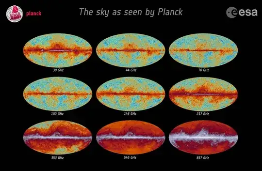

The main way that, for example, Planck, removes foregrounds is by making observations at a variety of different frequencies (see image below). This allows comparisons between the different maps that make it much easier to remove astrophysical foregrounds. This does involve prior knowledge of the types of radiation that are most prominent (synchrotron and thermal dust). The accuracy with which Planck does this was vital in challenging the BICEP data a few years ago when their neglecting of the emission from dust led to an announcement of a detection of B-mode polarisation from inflation.
With regard to your 4th point, Planck's predecessor, WMAP, didn't use the data from the galactic disk due to the high intensity of foregrounds here. I'm not sure if Planck does the same (they certainly show cleaned maps of the full sky on their webpages).
Finally the Doppler shift of the CMB due to relative motions of the galaxy and the Earth are easily subtracted. The method for this is a little more mathematically involved, however. The basic idea is that we can deconstruct the full map in terms of a sum of functions (spherical harmonics) and the dipole caused by the relative motion only affects one of these (the one for which l=1) which can consequently be ignored. (look here http://background.uchicago.edu/~whu/intermediate/map5.html for more details).
Separate Planck frequency maps
