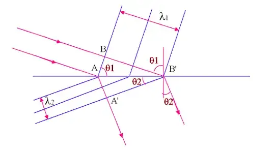

The wavefront concept of Huygen's principle can be used to derive Snell's law. Perhaps your question will be answered if you take a look at the derivation of Snell's law.
In the following figure, wavefront $AB$ carries the incident rays and wavefront $A'B'$ carries the refracted rays. Note that each wavefront is perpendicular to the rays it carries.
The ray (wavelet) at the A end of wavefront AB arrives at the interface first. The wavefront at the $B$ end arrives at the interface Δt seconds later because of distance $BB'$. Of course, $BB' = v_1\Delta t$ where $v_1$ is the wave speed in medium 1.
Meanwhile, the ray that arrived at A first travels a distance AA' in medium 2 that is shorter than BB' of medium 1. Of course, $AA' = v_2\Delta t$ where $v_2$ is the wave speed in medium 2. The assumption is that the speed of light in medium 2 is less than that of medium 1.
For this reason, light has to bend and get closer to the normal line if it moves slower in medium 2. Triangles $ABB'$ and $AA'B'$ both share the same hypotenuse $AB'$. The angle opposite to BB' is the same size as $\theta_1$, the angle of incidence. The angle opposite to the shorter length $AA'$ is the same size as $\theta_2$, the angle of refraction.
Proof :
$\sin{\theta_1}=\frac{BB'}{AB'}$ $\tag1$
$\sin{\theta_2}=\frac{AA'}{AB'}$ $\tag2$
From the above relations,
$\frac{\sin{\theta_1}}{\sin{\theta_2}}=\frac{v_1\Delta t}{v_2 \Delta t}$
$\frac{\sin{\theta_1}}{\sin{\theta_2}}=\frac{v_1}{v_2 }$ $\tag3$
But as we know, $n=\frac{c}{v}$, equation $(3)$ becomes,
$\frac{\sin{\theta_1}}{\sin{\theta_2}}=\frac{n_2}{n_1}$
$n_1\sin{\theta_1}=n_2\sin{\theta_2}$
This is how the $sine$ function introduces itself in the Snell's law.
