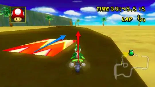

For me, when you are doing a dot product, you are thinking on how a vector influences in another vector. For example... When you are playing Mario Kart, you have some boosts in the track:
enter image description here $$ \vec{a} \text{ } \cdot \text{ } \vec{b} = |a||b|\cos(\theta) $$ Consider the $\vec{a}$ the red vector and $\vec{b}$ the blue vector. If the angle between them is $0$, you'll see that you are going to get the maximum boost possible, because $\cos(0)=1$. When you start increasing the angle between them, you can see that the dot product is going to approach zero (can you tell why?).
Thinking that way, you can see that the the scalar, that is the result of a dot product, is telling you how much one vector is influencing the other one.

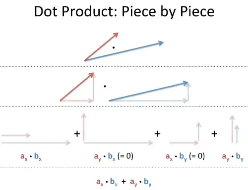

One other thing to build your intuition is to think about how to the computation of a dot product is done:
All images I've got from betterexplained.com, I recommend this site for building up your intuition.
