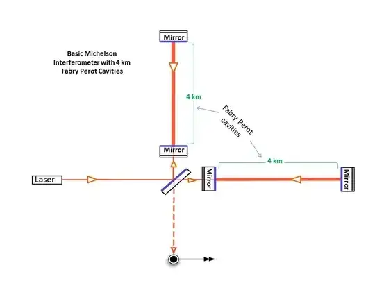

- The length of LIGO's arms is $4 km$ each physically, and $1120 km$ virtually – see official source and Fabry–Pérot interferometer.
